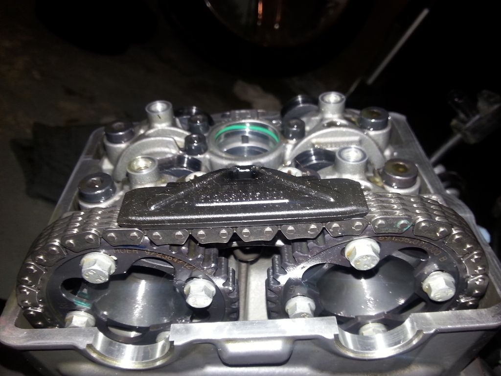

Spent 30 mins or so last night fitting cams on rear cylinder. Ensuring dots lined up as they should, and all was well.
Tensioners were in, but not "unlocked" and as I rotated the engine to check alignment the cam teeth skipped on the chain, so Ill re do that. Even though the chain felt tensioned fairly tight (even without tensioner tension) it still skipped. But its a 2 min fix to redo it.

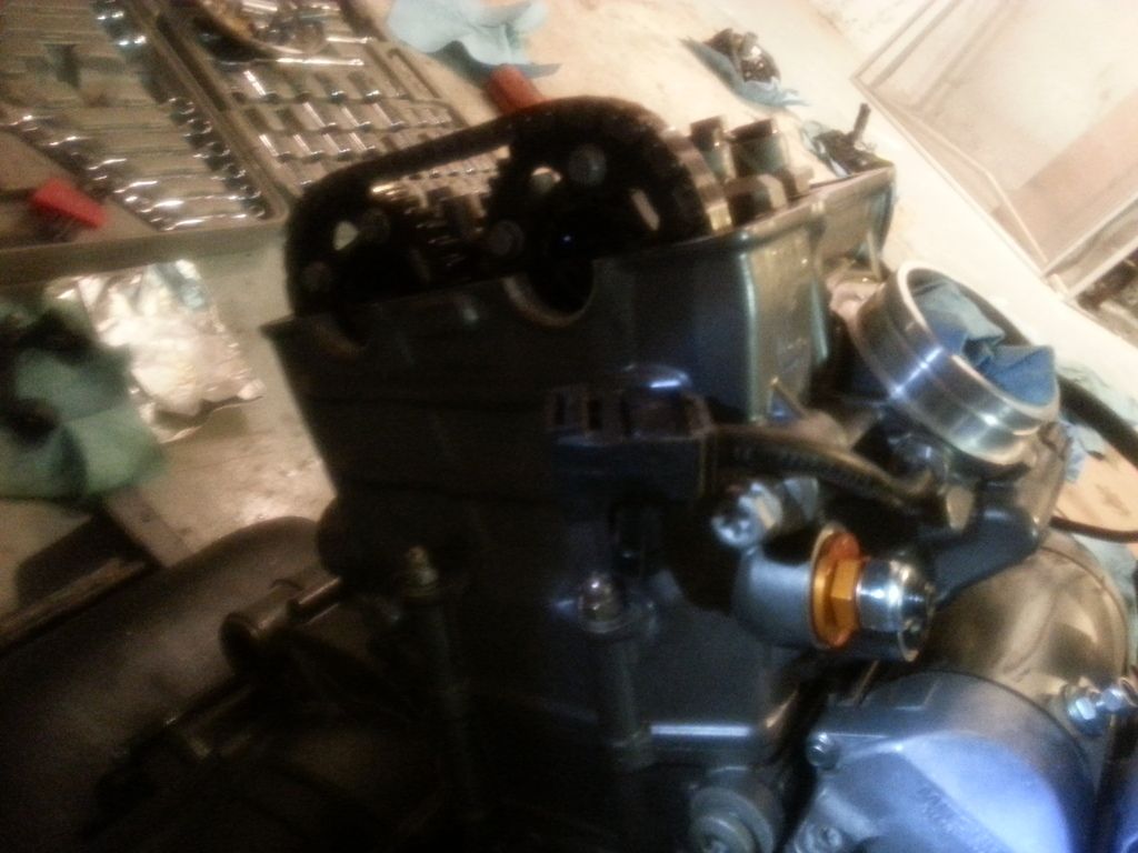

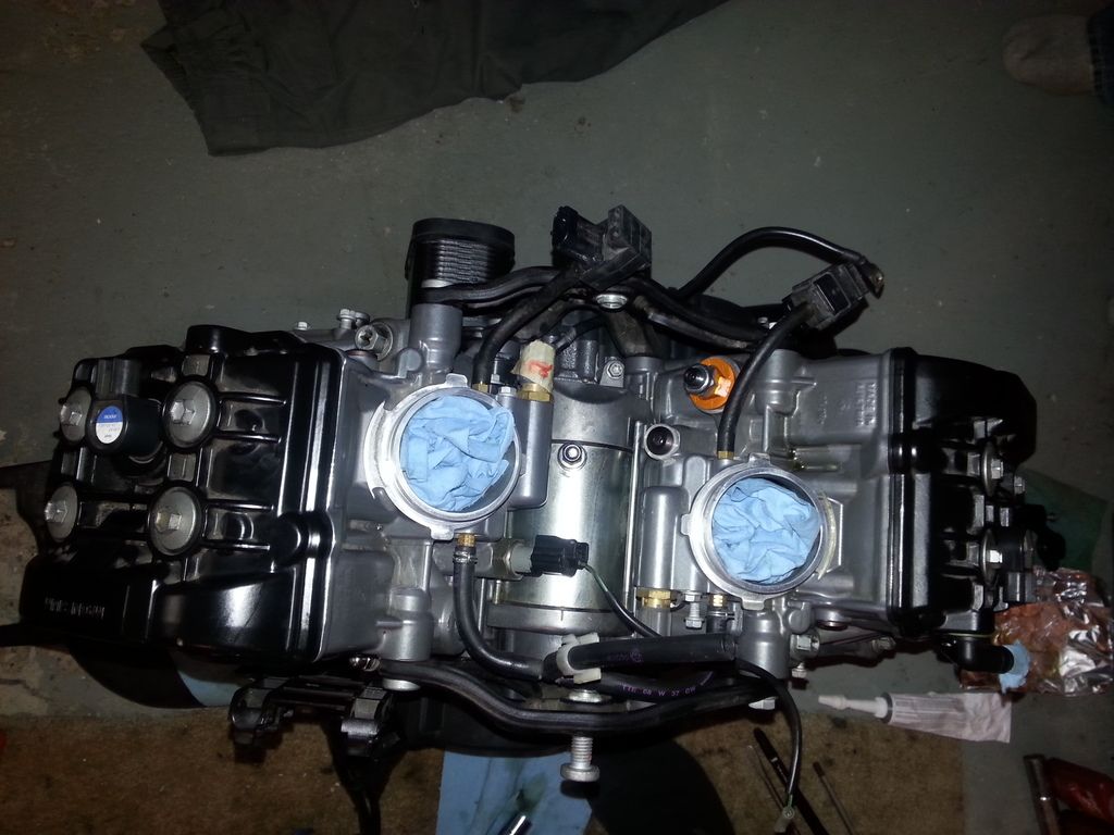

Engine built and timed, new tensioners put in. Realizing now the rear cylinder will be a pain int he *** to tighten when it comes time to tighten the tensioners. Likley another reason KTM went hydraulic autos. See pic of how they look below (See orange anodized dealy in front cylinder. Coulda sworn I took better pics....guess not)

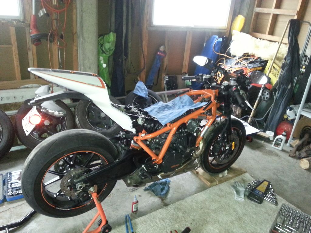

Engine IN bike, was fitting up the airbox yesterday (major pain to get the rubber grommets and throttle linkages in their spot, its still not in correctly haha). Lots of swearing yet to come. Got the rad in, and my fancy new SAMCO orange silicone hoses, which look pretty good, I get pics.
Rigged up exhaust, and rearsets and shifters. have yet to bleed the clutch fluid, I was mocking it all up to make sure I have all bolting and whatnot. Swingarm on, tire on, most of the connections are made except for the gas tank connections. Which will likely be the final ones before I attempt to turn a key over. Engine was the easy part its this **** that's all hard to remember and ****ed!
Just have to put some inner fenders on that hold some wiring connections, clip them in, finish my throttle stuff / airbox....get gas tank on. Battery in....
Dare I say ready to fire?? Dear god I hope all goes well. Im assuming it wont fire instantly. Ill have missed a ground or something somewhere, have to rework some wiring and that kinda ****. BUT...maybe it will! There is the ground connection coming right off the battery post that I cant remember where it goes. Anyone know? It looks to kinda fit to where a bolt that holds the starter goes, and act as a chassis ground? I THINK.
Between working 12-14 hours a day for 6 weeks, being out of town, single and trying to get laid, fixing my car, cruising in truck.....I MIGHT still hit my May 5-6 startup date for the bike believe it or not.
Pic shows engine in! But that's before accessories and airbox as well.

Reset my front timing by a tooth, as that's all it looked like it was off during my checks yesterday. Hard to tell with coolant hoses being right in my line of visual checking. And I know where I went wrong earlier. Stupid mistake, spun the crank once, not twice on one of my final checks and noted the wrong indications on the cams. Could have been much worse I suppose. Spent 6 hours on it yesterday resetting the front cams, as the engine is in the bike and not friendly in adjusting. the REAR cylinder has lots of room, if youre gonna **** one up **** that one up! See pics...I had to remove 4 engine mounts from the front and pivot the engine low enough to allow clearance for the 5 mm hex head socket.
BUT now the timing should be correct, I hope! The manual is rather vague on which indications you need to line up as theres 2 sets of markings. FR and RE on each cam. The manual doesn't note which markings to align when at TDC of each cylinder. BUT if you match what the pics look like the front cylinder needs to be aligned with markings FR in the middle of the cylinder head @ TDC, and one crank rotation out, the FR should align on the outside edge of the head. Another crank rotation should complete the 4 cycle and you should be back @TDC with the FR markings in the middle. Tough to tell in pic, and this is when it was outside the bike but this may help:
Conversely, on the rear cylinder the markings based on how the pics in the manual look, are RE for all TDC settings (rather than FR on the front). I attribute this to FRONT and REAR ??? I don't know. But its the only way everything aligns when installing like the pics of cams I posted above in a prior post. Im going out on a limb, but it seems to check out with my pre-tear down pics of the cam assemblies.
