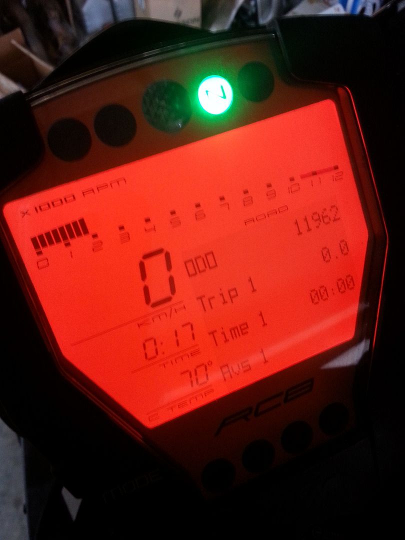

It started!! Found/bought new battery on way home. Yuasa YZT14S.....$200!! From Yamaha...KTM wanted $250!
Starts, idles, revs at least to 4k. Throttle not linked up yet, so was working the linkages by my thumb. Got it to running temp, fan kicked on. So far so good.
No leaks... yet.
Smoked a little from solvents and oils and coolant, etc, etc. As expected.
Felt a reaction to the throttle linkages through my thumb from rear cylinder. Sounded backfire-ey...Still unsure about it. Thinking possibilities. UNder accel it didn't do it, just when on/off increase in throttle pressure. Wondering if fully doing up the upper airbox and SAS system, gas tank breather hoses will have any effect on that "pop' feeling I was feeling. I hope so.
Also wondering about new tensioner. Which way to adjust in/out. Adjusting it now while tank is loose and its availability to adjust later decide that it should be done before carrying on too far. Dont wanna adjust TB linkages with my fingers/hands anymore in fear of explosion so ill hook the cables up. Which will aide the idle by providing just a miniscule amount of pull it seems based on me playing with it. Hopefully the TPS settings and whatnot still apply from calibration. I didn't physically change any linkages, so hope the software portion remains fine.
Still no CEL or errors via the dash.
Few bits to take care of then around the block?? See if it drives/shifts ok. Have news shift star also installed. Gotta bleed hydraulic clutch as well. All the small stuff now.
But all this will happen over the next few days. My heart can maybe start beating again since it at least started. Engine adjustments (besides tensioner adjustment) shouldn't be necessary now??? I hope not I don't wanna do the top end again... or anything again. Hope it revs smooth. Kinda sounds like I remember from 8 months ago.
Yeah starting it is JUST the start. I want it running as well as it was! Ill do the upper airbox up completely up, route the gas tank breathers and the PCV hose from the canister. (Which by the way put tons of smoke into the second TB apparently. I watched as it belches smoke out. Have video, too large to load or something. I dunno)
Im hoping buttoning this up will smooth out the fueling or something. Something still seems off about the way it FEELS on the rear cylinder. Maybe too much air? Not enough vacuum in the airbox since its all open/exposed right now? it idles just fine, but revving it up I feel some back-pressure or something from the rear. Could be secondary butterflies NOT opening and stalling out? But theyre servo actuated so it would require a certain RPM to actuate...so maybe that's not it. Doesn't feel healthy anyways. Then it stalls out sometimes. So im not out of the woods yet. Really wanting to figure it out and not tear the valve covers off again as I don't know how that will help anyways. Hoping its all fuelling and airflow at this point.

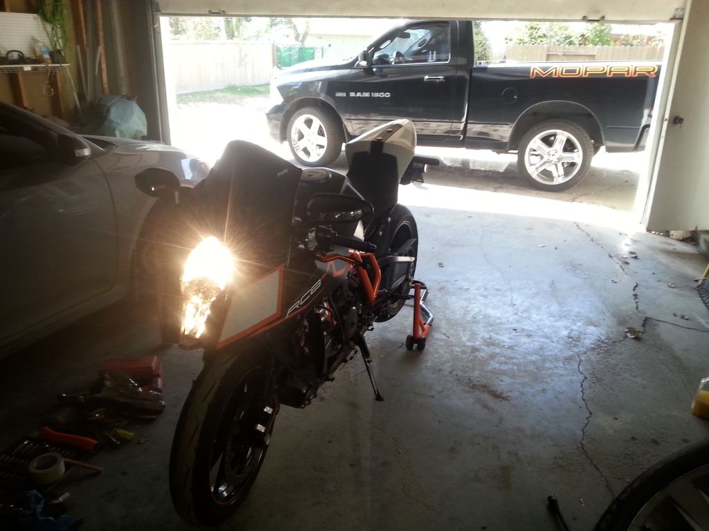

Hooked all the rest of the stuff up as mentioned above......seemed to smooth it right out! Throttle linkages all hooked up and airbox sealed, PCV vent routed back into the TB (thinking I should just route this through a filter out the bike. Seems better for the bike. Gas tank vents are on Just have to squeeze the tank back into its spot.

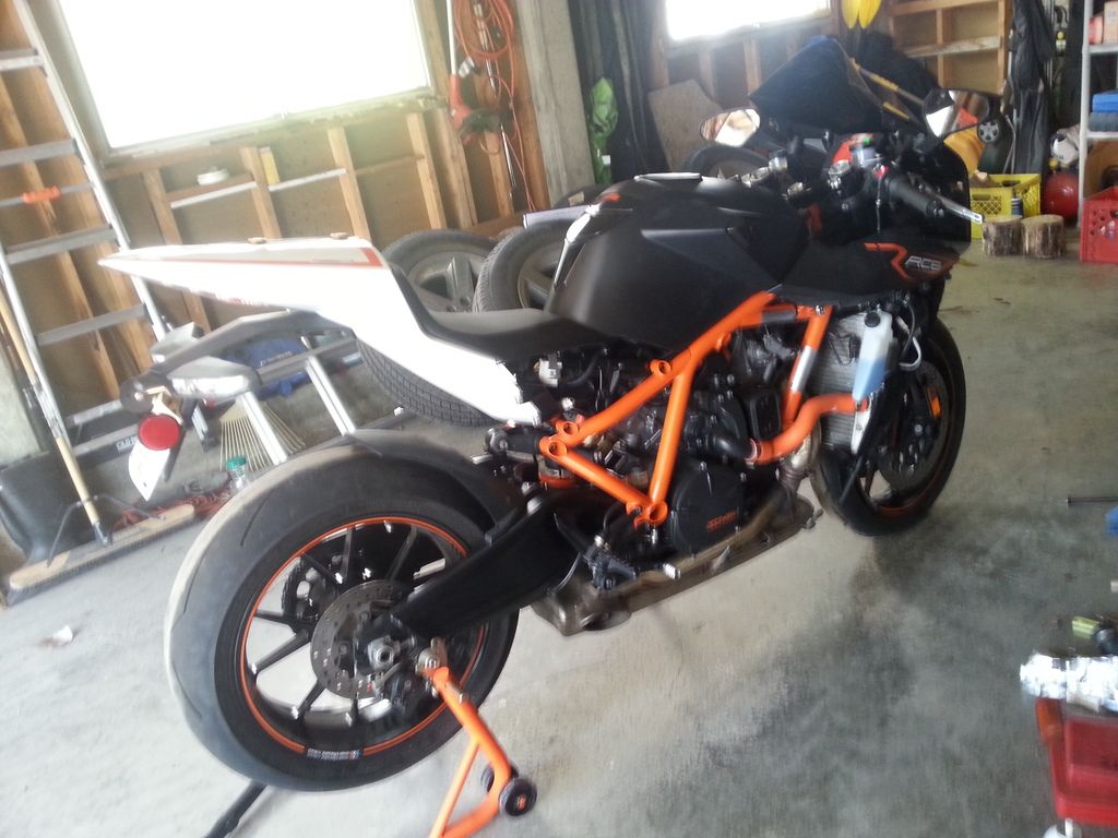

bike together, timed correctly. Running and all.
Havent bagged it hard to see if it hold, have no real reason to suspect it wont I suppose.
Have about 100km's on it and it seems to be doing its job. haven't put the side panels on just in case, so its not completely done yet.
All in all it works. hope it keeps working.
Gas tank didn't quite fit , had to drop the subframe to get it all lined up and it all worked out after. hoping it doesn't start leaking like most KTM's again soon!
