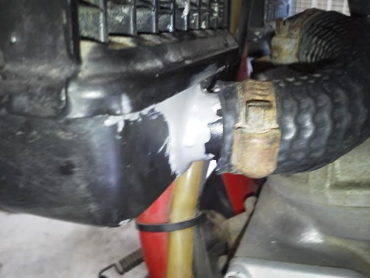

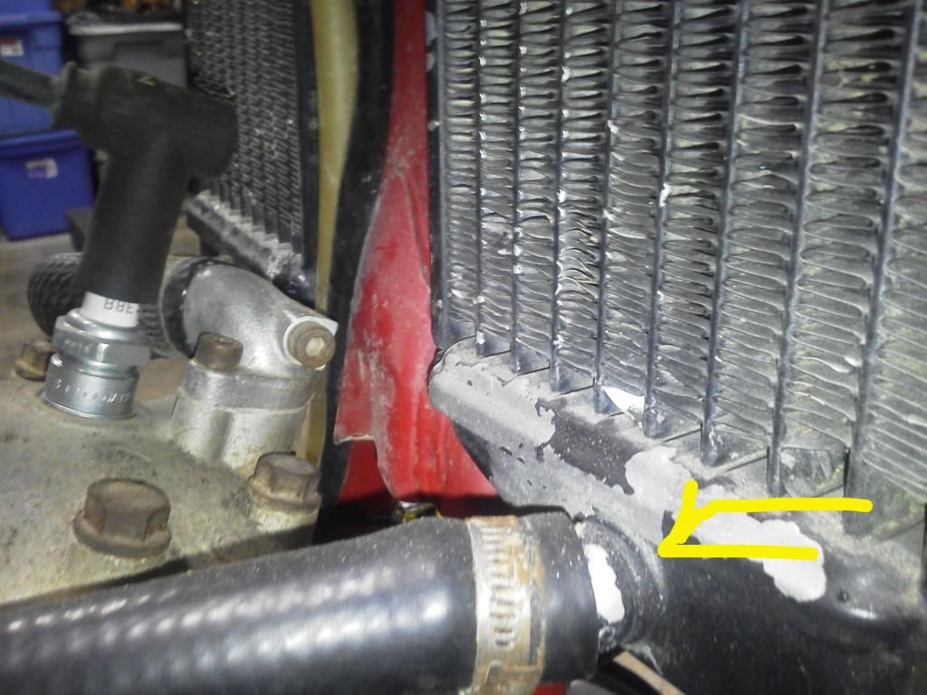

I looked at the radiator and could not locate a drain plug. Do you mean pull this lower hose here?
Is that it, just drain it? Do I need to flush it out with a hose? Or boiling water?
It seems to be completely is dry inside.
76 Posts
The water pump is on the engine at the other end of that hose. You
want to drain the water at the lowest part of the coolant system. If it
is dry there might be deposits left inside the engine and radiators and
would be wise to flush.

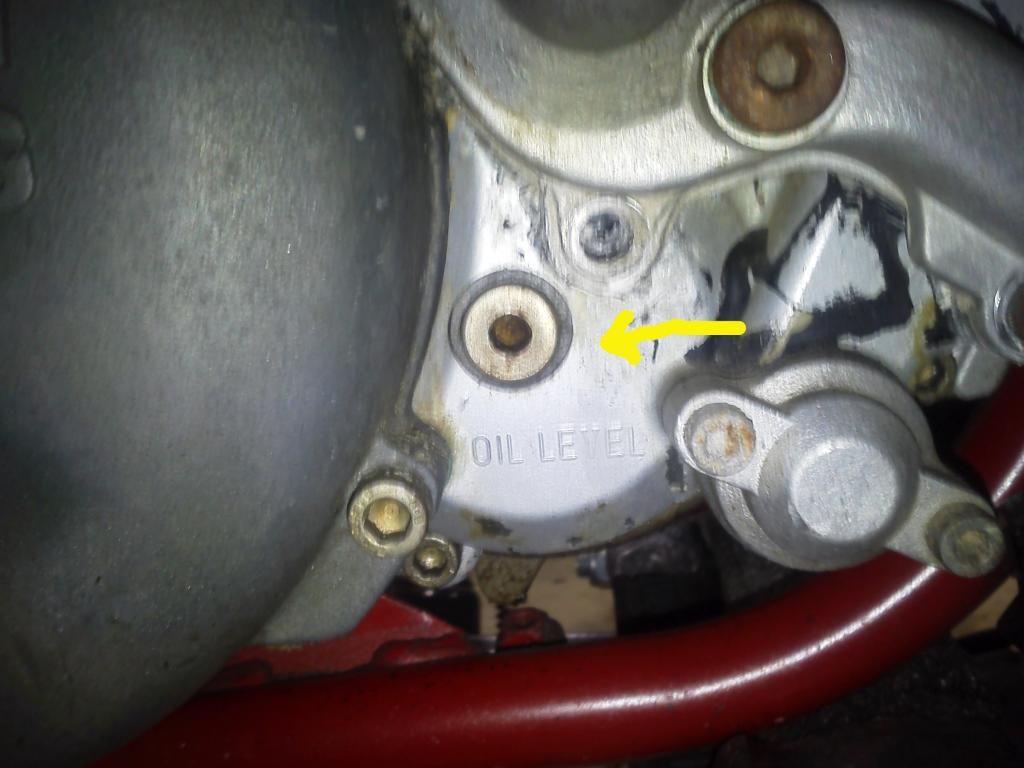

You will have a drain for the engine oil as well. I would change it again
after the first ride also because it has been sitting so long.

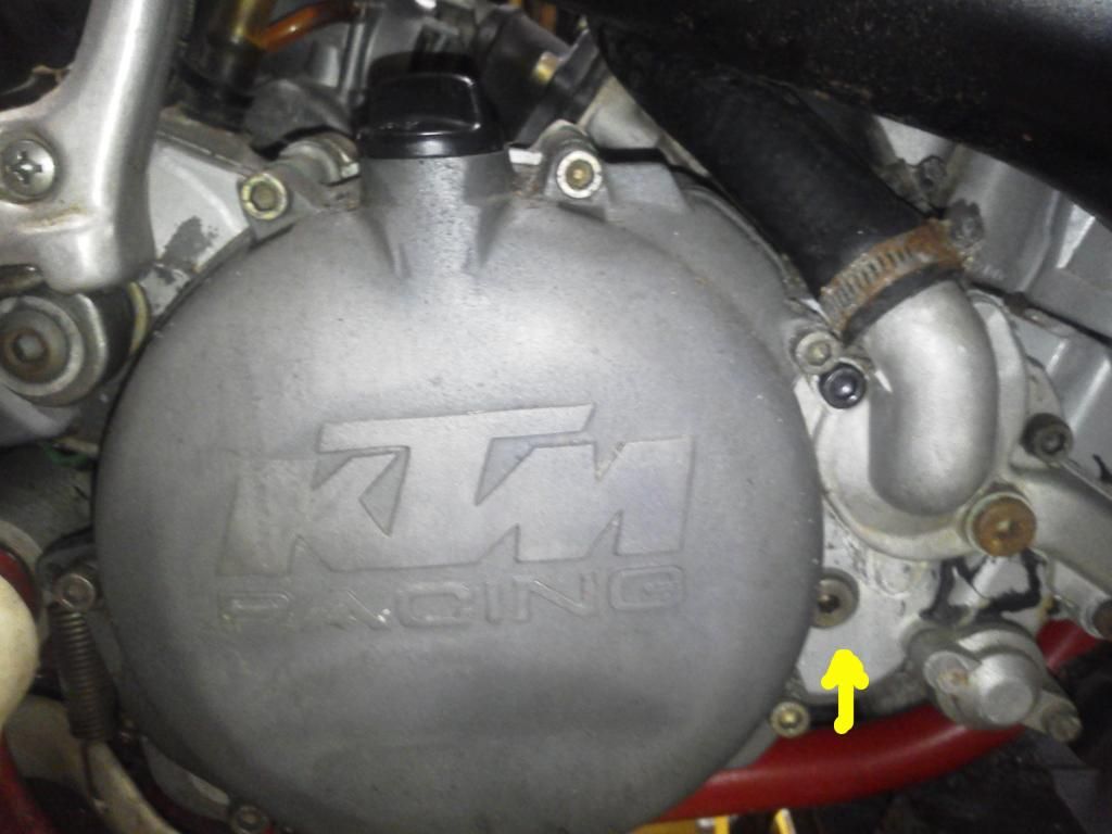

I also checked underneath the engine and did not see/could not locate a drain plug like I have on my KLR650 or my XR250L?
The check level screw is all I can locate along with the filler cap?
Any certain amount of ounces or just fill until it begins to weep out of the oil level hole?
Again I appreciate the help.

76 Posts
The first picture is the coolant drain. There is most defiantly a drain
plug on the bottom of the crank case. Lay the bike on the side if your
having trouble finding it. Otherwise I would pull off the clutch cover to
drain, but there has to be a drain plug. Good luck!

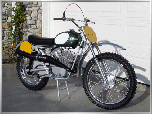

And nice bike by the way! I especially like the Penton!

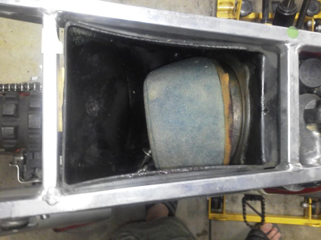

Air filter looks good. Maybe just clean and re-oil it. I am wondering if there is supposed to be a cover over the top, if so there is not one? Is this some sort of mod or do I need to be looking for one on e-bay?

There is a cover with holes in it for extremely wet conditions but I've
never needed to use it. The reeds will not lay flat against the cage and
will start to crack and split when they wear out.
Premium Member
14,812 Posts
Rangerman
Yes!
Just pull the fill level plug and add oil into the top
fill hole (with the black plug). Go slow and as
oil starts to weep out plug her back up and your done.:yes:
76 Posts
Yes!
That will work, it should take about 1 quart. My 360 took .8L.
