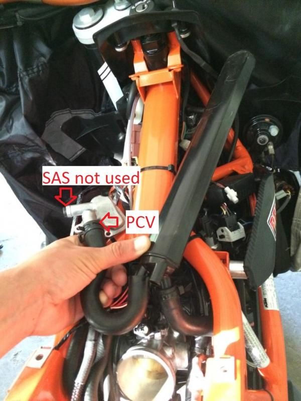

Alright fellas well I hadn't seen anyone do this with their Duke or at least post it up and since getting the auto tune it was necessary to remove the SAS so it doesn't screw with the Autotune. I had originally bought the SAS valve removal kit thinking that it was the same as the previous years since that's how it was listed online in order to keep the FI light from coming on. I was taking it apart when I noticed that the hole that gets plugged up already is plugged and it doesn't have the solenoid so I basically had no use for it. Contacted the seller (smart moto) and he refunded me the money without having to return it since he wasn't aware. So I bought just the blanking plate for the 690 SMC since they use the same SAS. I'll be updating this as I go along maybe I'll take some pictures in the daylight so everything is clearer and replace these.
Took the valve off and now on the new model they have this huge plastic can which is an air/oil separator in the middle of the frame that one of the hoses connect to from the SAS which from the plastic tube there's also one that gets routed to the airbox and also another on the bottom that another hose gets connected from the crankcase which is the crankcase breather. By the way in order to get to this the airbox will need to be taken off. I waited till I bought the cam and airbox to do this for this very reason. Got a better picture here you can see where the SAS is connected to the plastic pipe and also the crankcase breather. The only one missing is the top right because that goes to the airbox which is currently off. You'll have to take off your air box and I pulled out the injector and loosened the throttle body to angle it down to remove the air/oil separator.
Here's the SAS blanking plate it was polished but I used some DEI black silicone paint on it so it wouldn't stick out like a sore thumb and blends in.
Now all you'll have to do is plug the hole in the airbox which I don't have a plug for yet since I just started this last night but even a piece of duct tape on the inside of the airbox will work if you can't find a plug for it. Now all your left with is the crankcase breather hose. Now I measured the size of the hole and I'll be ordering a small crankcase breather filter so that dirt doesn't get inside and let's it breath and you'll be done with the SAS removal:

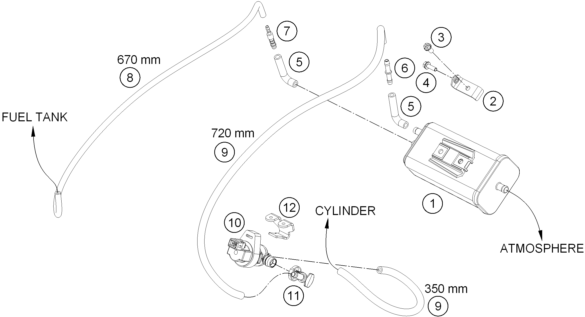

Now for the charcoal canister. This is located behind the battery. You can't see it unless you take your battery out. There's two hoses that are connected to the gas tank that you'll have to remove on the left side of the gas tank. Here's what the whole assembly looks like once removed. Got a better picture of this I placed it where it would go and semi routed the lines to where they went so you guys get a better idea.
Now the second gets connected to the solenoid which is on the right side of the throttle body (if your sitting on the bike) that you'll have to disconnect. Once you do you can pull the canister out.
Here is a picture of the hose you'll be pulling off the left side of the throttle body that you will have to plug with a 1/4" plug.
Now to remove the solenoid you'll have to pull this metal clip out to disconnect it. Once you've done that and have pulled out the hose next to he throttle body you can pull out the solenoid. Keep in mind you WILL need a resistor if you pull this off.

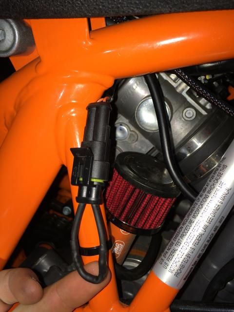

I just got doing the same project on my Duke. I left the charcoal canister as is and left the crank vent hose running into it. I used the emissions block off kit provided by KTM Twins (looks like on back order now). I did not need to plug a resistor into the solenoid connector and am not having any issues with fault codes.

I remember doing some investigation on this awhile ago....especially the charcoal canister and associated tubing.
My investigation started when folks from Europe mentioned fuel was dripping on their valve covers degrading the paint. They also pointed out the source under the tank seemed to be missing a tube that the USA spec bikes have.
I will be leaving these components intact as KTM has neatly tucked these away and I wont have any issues with fuel overflowing or allowing moisture into the tank...or the FI indicator.
I will however install a block off plate - block the crankcase vent at the top of the head mainly to make maintenance MUCH easier!
It also should be noted our bikes actually don't have the conventional SAS plumbing/soleniod as other bikes do - ours is actually blocked :yes:

I'll be getting a long line of that fuel over flow hose and just routing it to the bottom of the motor so if it does it just spills on the ground so that won't be a problem. I don't know why the FI indicator would turn on because it's not connected to anything that would trip an FI light.
I did make a note of it..it's actually in the first paragraph where I discuss that ours is indeed blocked off already and had bought a kit thinking we did have the solenoid that included a resistor but the. Had no use for it after seeing that.
Thanks for labeling the picture hopefully it helps others.

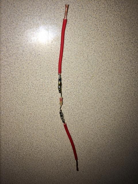

Sorry for the delays fellas here's a little write up on how I did my resistor to keep the charcoal canisters solenoid from tripping the FI light.
First off go to your local electronics store that would sell resisters. Here's what you'll want. You can also buy them off ebay but you get a ton which I wouldn't need and these only cost me a little over a dollar

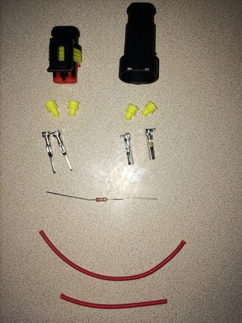

If you go my route I bought an electrical connector from ebay also to make my connection nice and legit looking. You'll also need a little bit of wire. This will be everything you'll need.

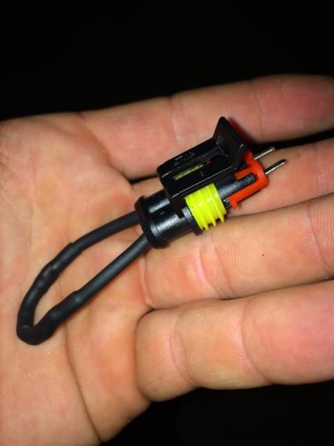

I soldered my wires together you could always use electrical connectors for this but I wanted it to be nice and sturdy with how much this bike vibrates.
I used some heat shrink around the two soldered wires and resistors and crimped the wires to insert it into the connector. Once your done with that it'll look like this.
Last step I cut the stock connector about an inch away and plugged the female end of my electrical connector in and voala! All done! Hope this helps you guys out. Again if you have any questions post away.

I did my 2015 690 Duke with a 22k resistor as shown, but still get an intermittant FI light.
The internal resistance of the solenoid removed is 21.5 Ohm, not 22k.
Wondering if a 22 ohm resistor should be used, instead.
I put the solenoid back on the bike till I can make another run to Radio Shack during the week.

If I didn't know what that was I wouldn't of gave you a specific name and if you saw what was in the link with the connectors you'd see that there's a male and female terminals that get crimped onto the wires then get pushed into the main body. So don't make something so simple complicated for yourself:turned:
