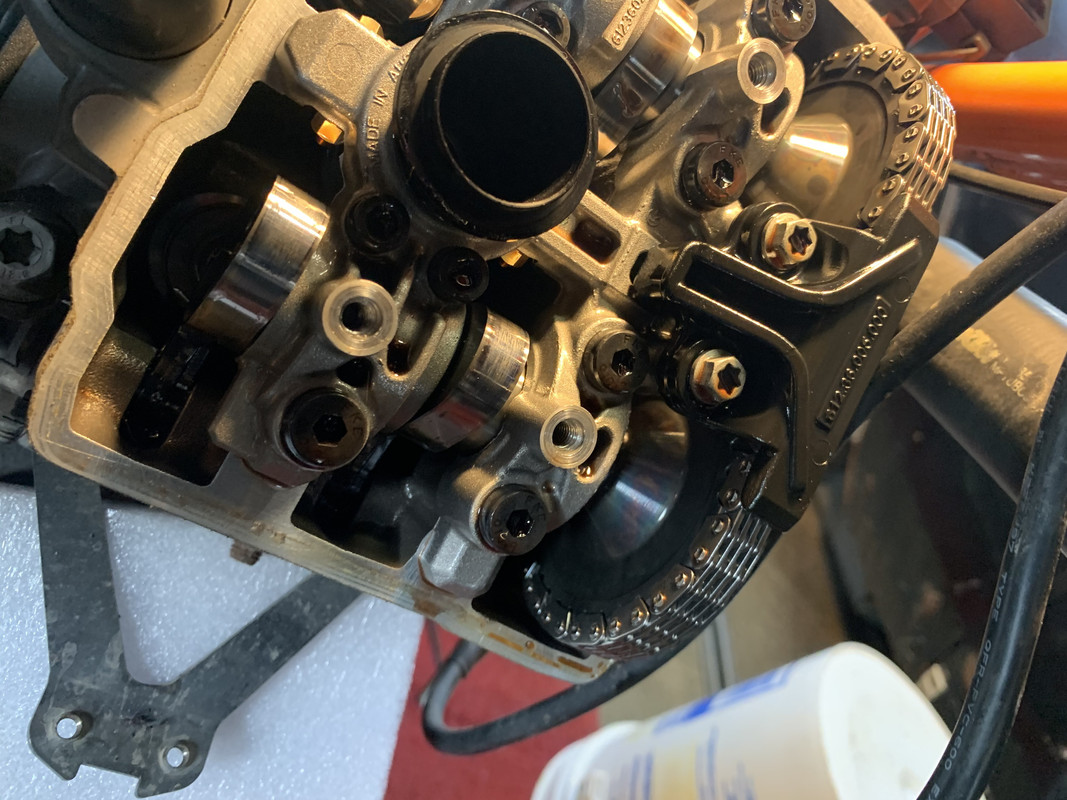

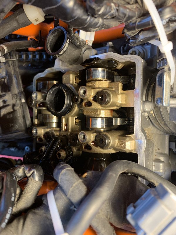

18K-mile service.
Valve clearance check
One valve out-of-spec

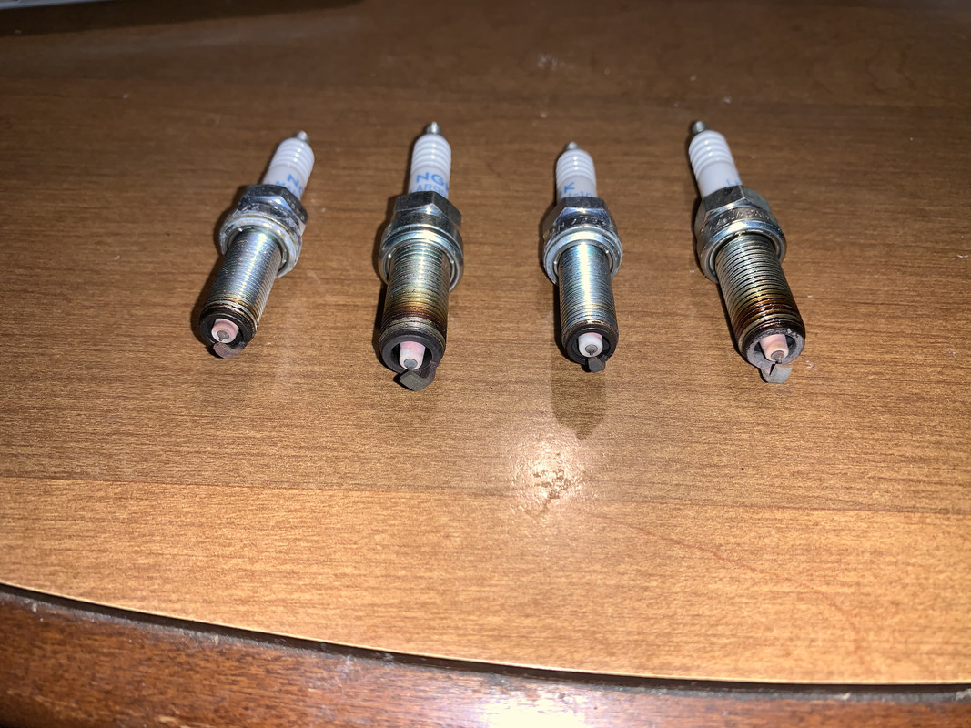

Plugs looked OK. I replaced them anyway since I had already bought the plugs. I was led to believe only 2 of the factory plugs would be Iridiums, but all 4 were.
