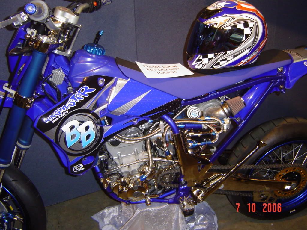

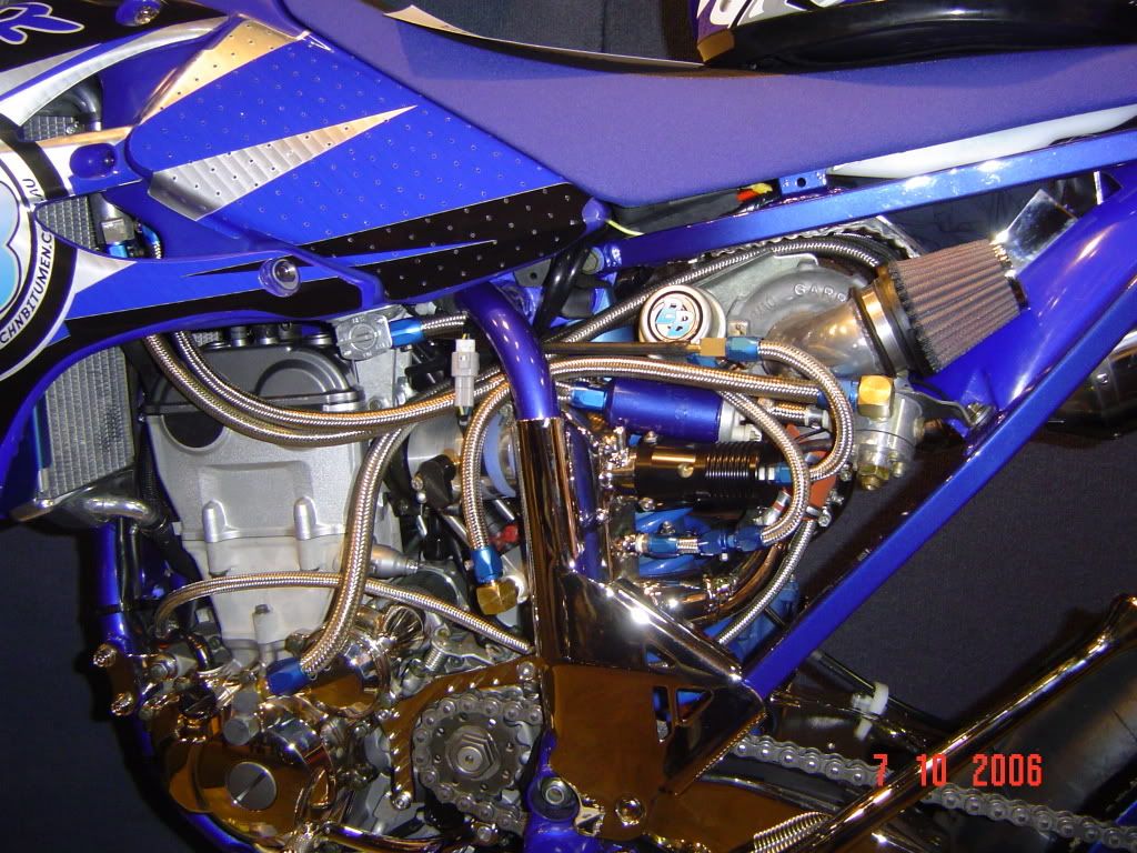

Jap 4 pots handle it pretty well, but there not hard on there cranks like a single. I was racing at a meet a few years ago where there was a yzf 450 turbo, so I got to see it first hand and it did work. Pictures of that bike below.
I gather you are putting it on an injected lc4?
I personally don't know of any kits, but making something up shouldn't be impossible.
I would be very interested if you decide to venture down that path. Can't see the turbo on the bike below but you can probably tell by the tubing.
