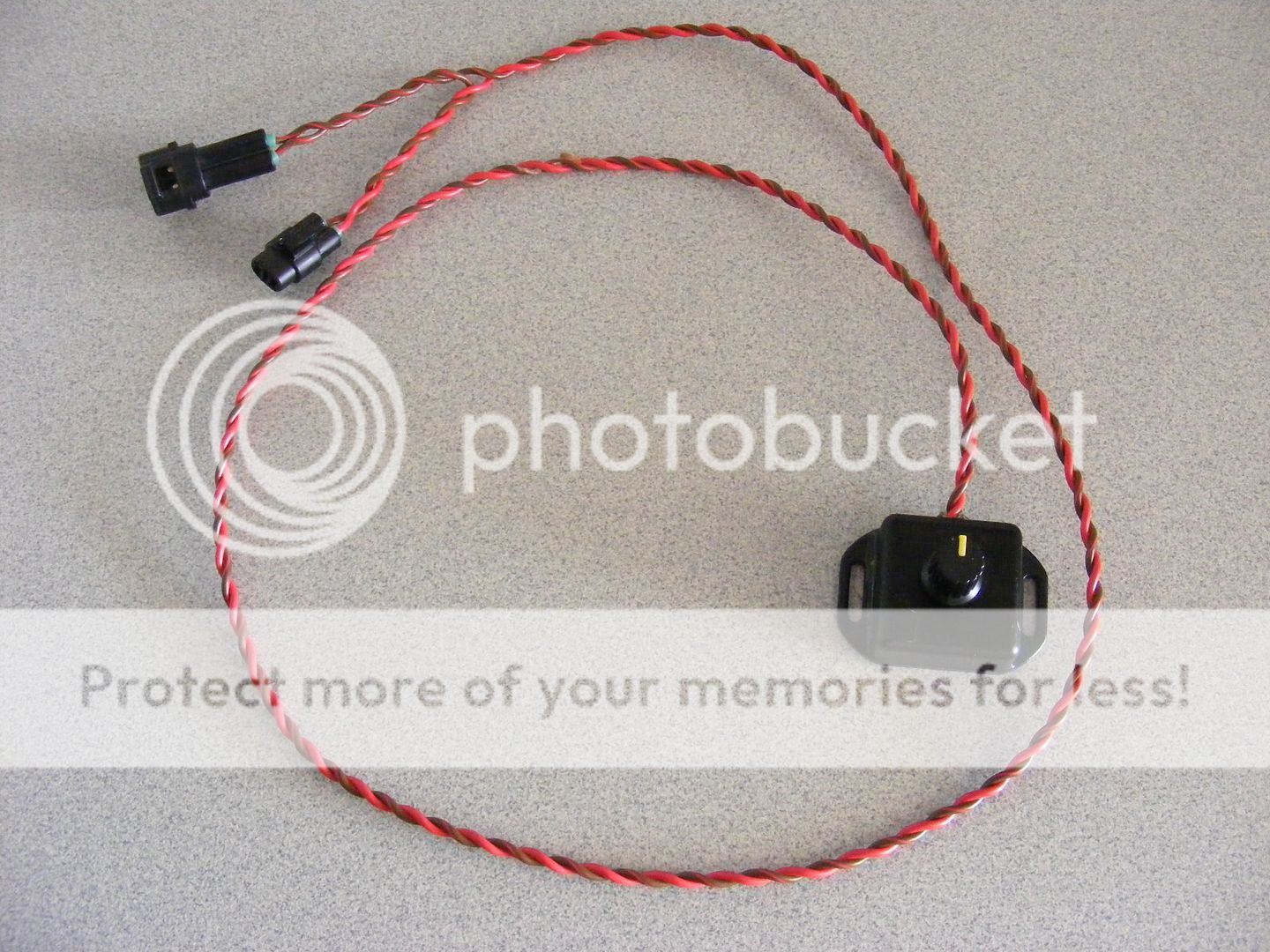

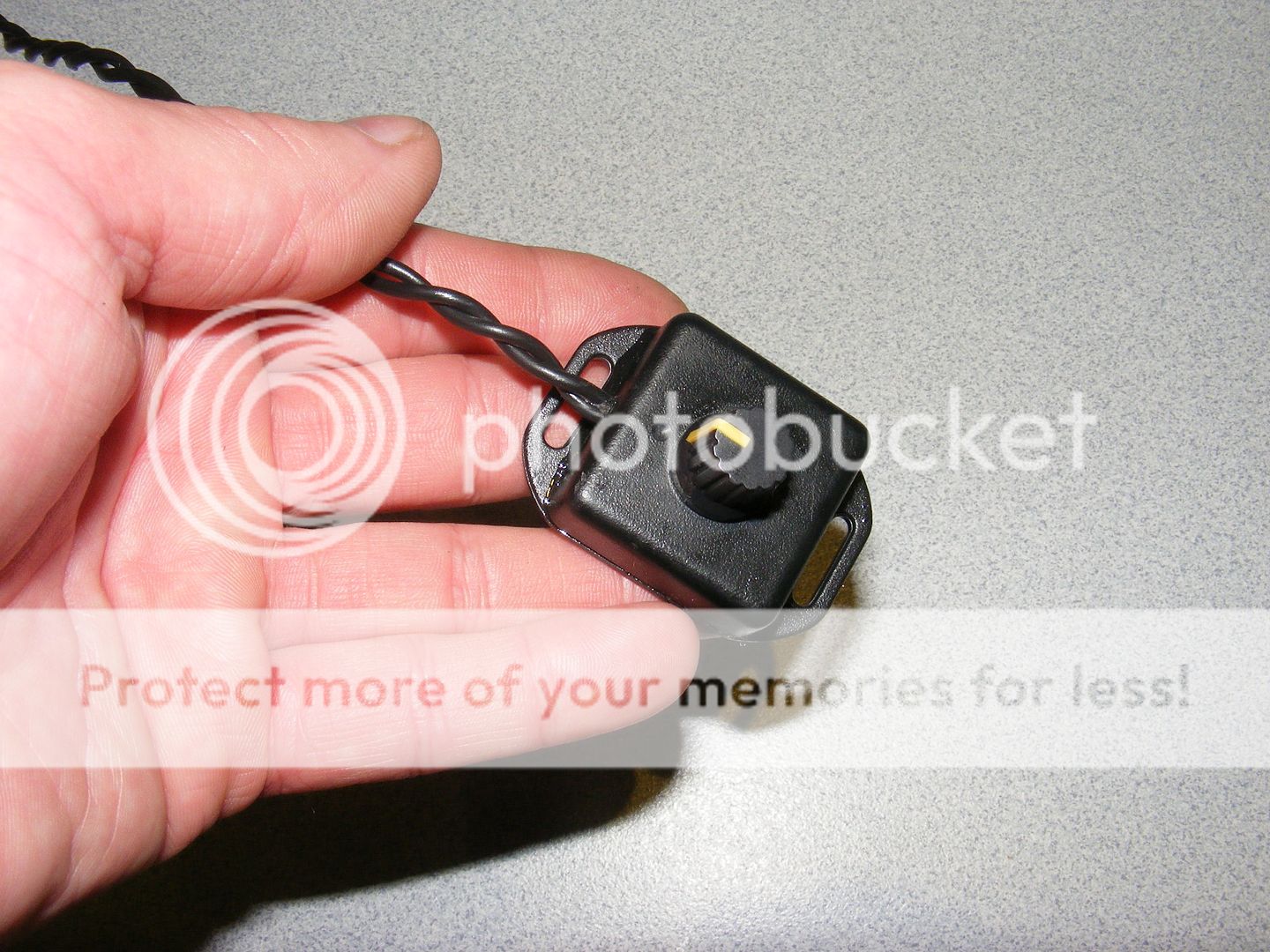

Seems like the perfect time to ask Kev. How come you stopped making the 690 fueling mod? I remember hearing something about the connectors were hard to source or something?
There is no way to obtain one? I'll pay double! Seriously, how do I get one?
I stopped making them because there was no demand, the connectors are easily found I used to import them from the USA to Oz in batches of 50x at a time, in the last year of making them I only sold 6 x adjustable fuel mods for the whole year I used to sell over 100 x a year, hardly worth the trouble keeping stock for so few sales. The same will go for the O2 controller once the demand is gone I will just move onto the next mod & bike giving trouble.

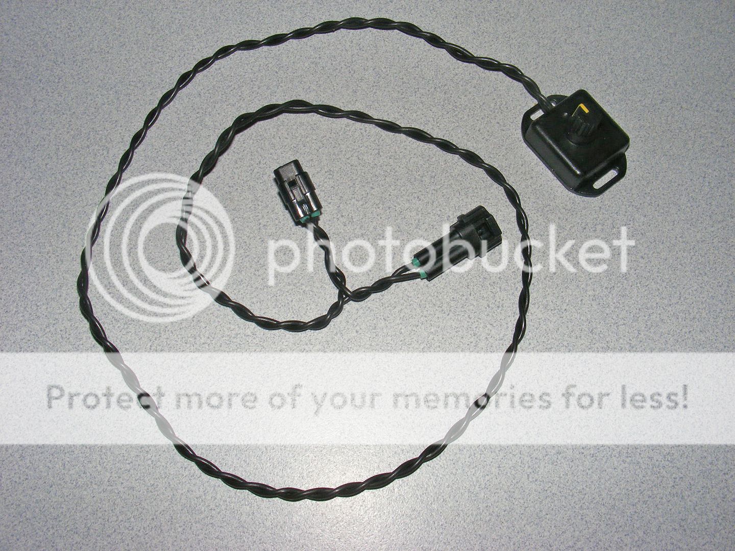

I had one of the o2 mods on my XT660 and will get one for my Duke 690, but even though they aren't made anymore, what was the fuelling mod? Any alternatives out there? I have a slip on can and was going to ad a decat pipe but worried about getting too lean. I *think* from what I've read i'll be okay with just the o2 mod for the closed loop?
the fuel mod was an ambient air sensor mod, which works when the sensor is on, all the time i guess.
the o2 mod targets part throttle cruise, it doesnt molest your acceleration maps.so its pretty renowned for fixing those part throttle problems.
the decat i suppose messes with the whole system, 02 mod is probably spot on for cruising.
for flogging it with open exhaust and open air filters its prolly running lean then gets better as the revs get higher, like from 6k to the redline.
